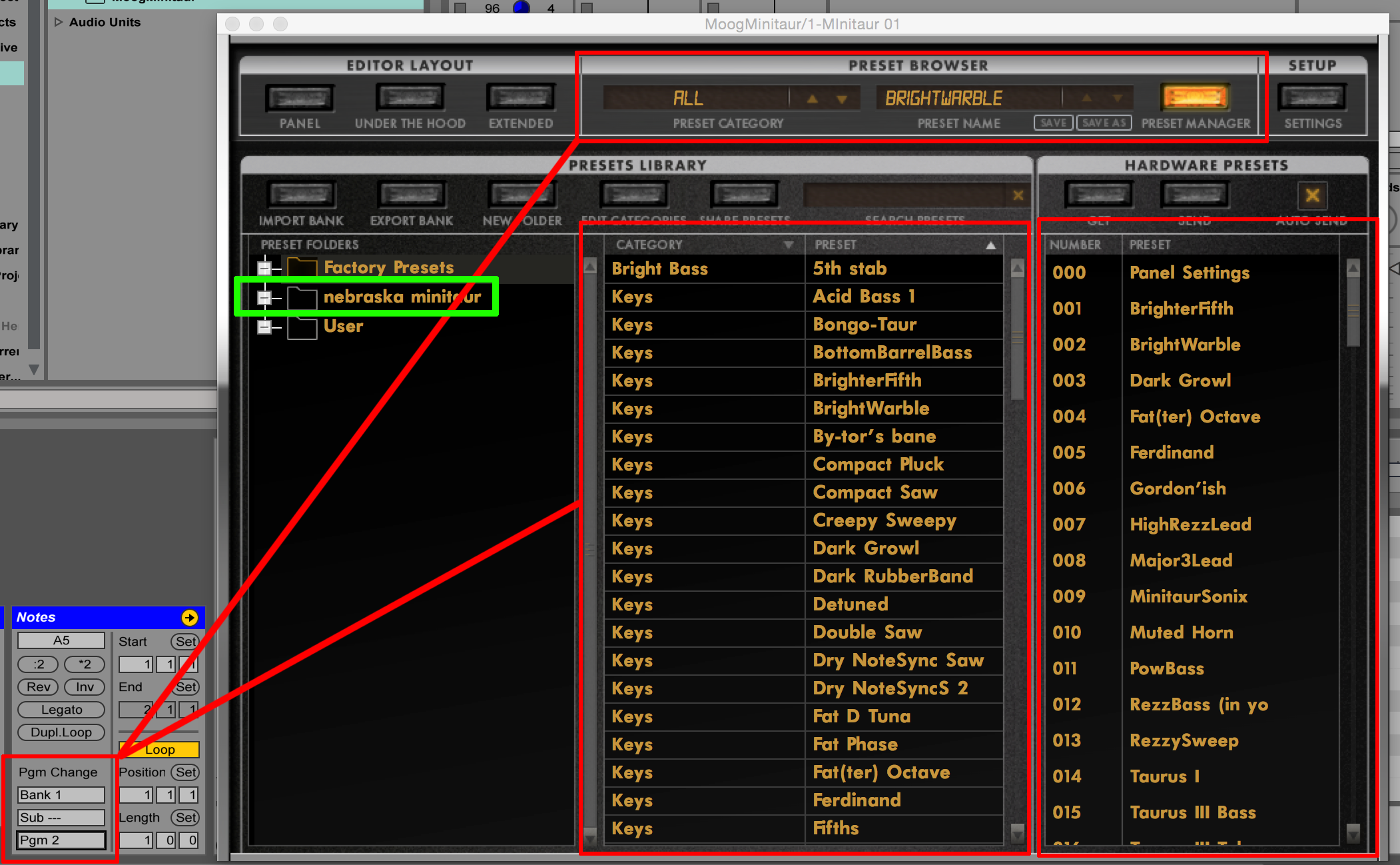

Has anyone successfully used an Ableton 'program change' (in the 'notes' panel) to switch the Minitaur from one user preset to another?
Changing the value of the 'Pgm' field definitely changes the sound, but this is not reflected on fields of the Editor plugin or standalone app for me. So have no idea what sounds I'm selecting from, or how to get to my saved sounds...

OK, think I figured something out:
"Pgm 1" in Ableton = "000 Panel Settings” under ‘hardware presets’ in minitaur editor.
So dragging and dropping user presets to replace existing hardware presets (and sending them to the hardware) enables preset changes via Ableton clips.
