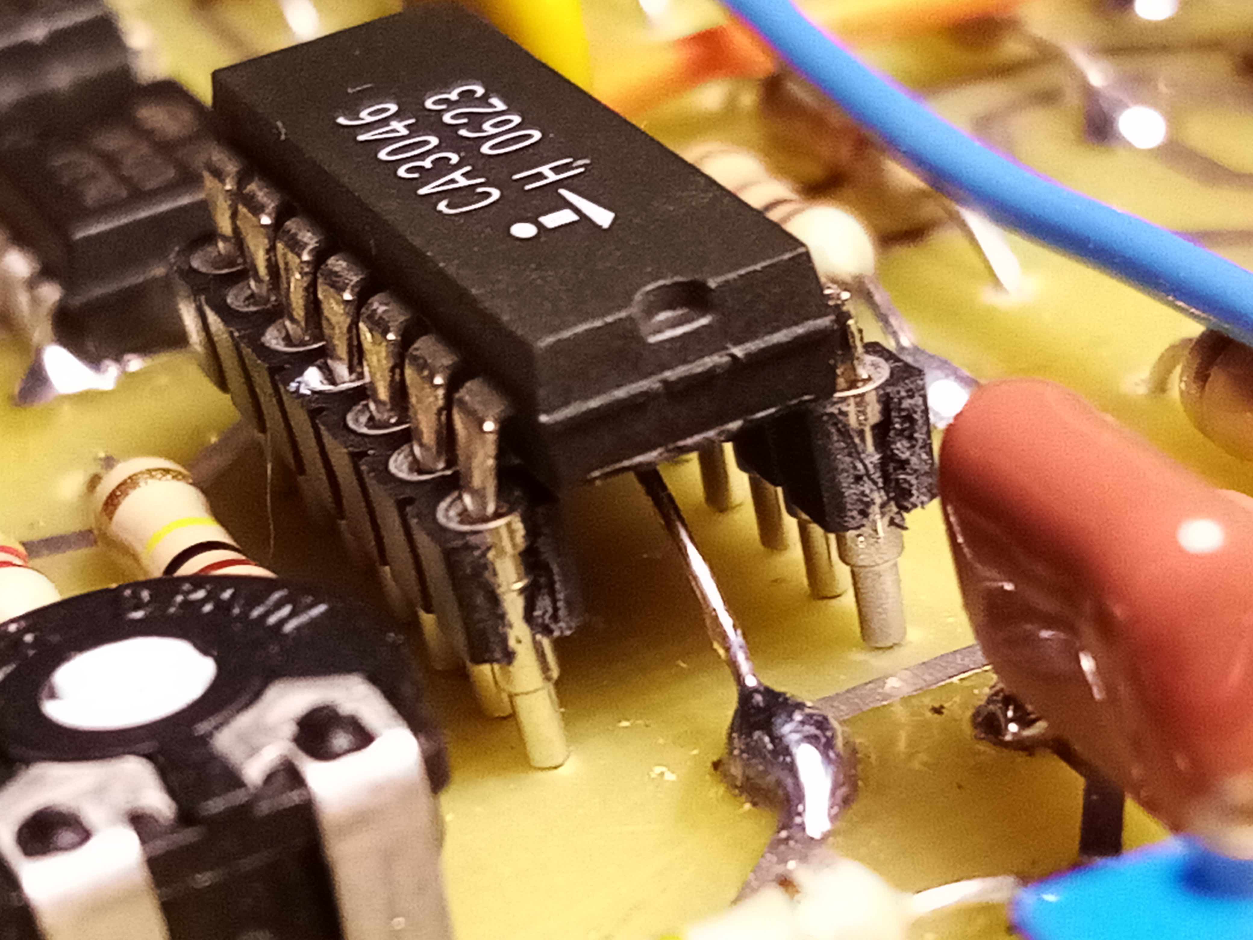

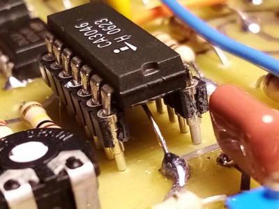

According to the original Moog 921 construction, the TC is mounted under IC508 (3046), that is mounted on sil sockets, so that enough room is available for the TC. Here are some close-ups taken from my 921 clone.

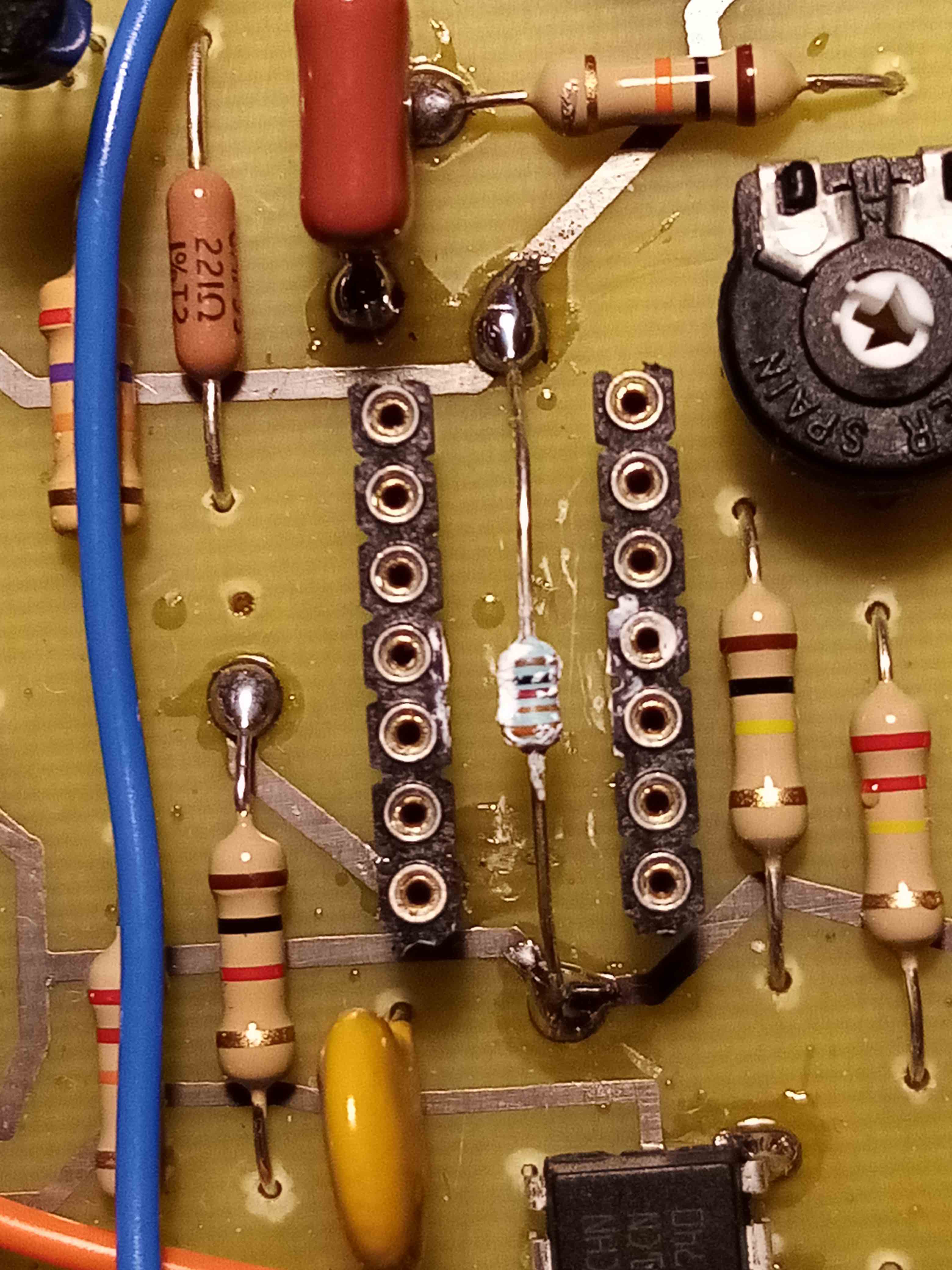

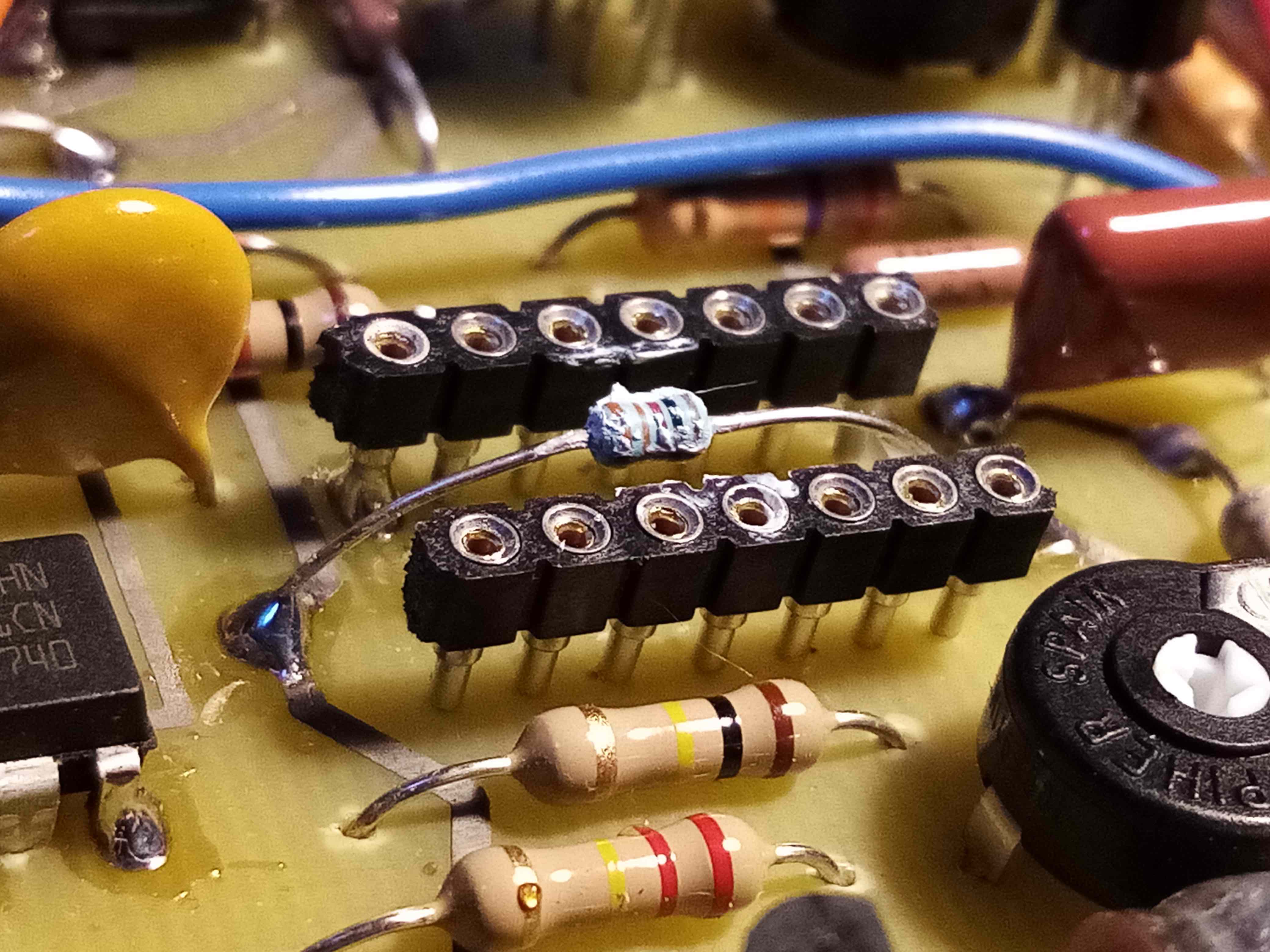

This is the same, with the IC removed, showing how the TC is mounted.
The TC should be in touch with the bottom side of the IC, with some heat sink compound, to improve thermal coupling
